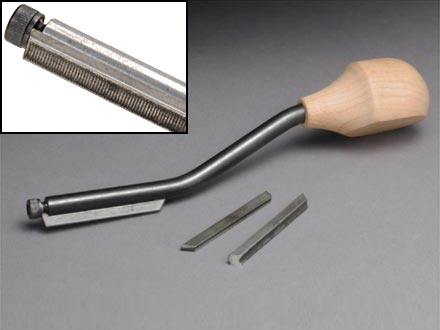

with a Dressing file like this
PostPosted: Mon Oct 08, 2007 6:15 am
It will file the fret to round from the sides inward Stop when you have a very fine thin at the center of the fret .005" or less. Then you need just to polish them out. This is called dressing the fret.
